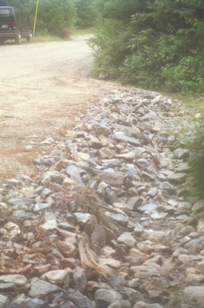

The top photo is of a developer's deep ditch filled with "rip-rap". As can be seen, grass has started growing in from the right side. Since this 2007 photo, after only three years in existence, this ditch is now 60% full of sand!

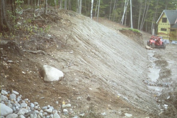

The biggest house—still unfinished after three years—has a semi-circular driveway of about 500 feet in length (pictured). Rain has eroded the clay embankment (center) and clogged the drains several times since they were installed in 2007. The most important drain, installed uphill late this summer, was itself washed out two weeks later! The builder's answer? Truck in more fill to refill the gullies!
The gray clay from that embankment roils the lake after each rain. The bottom photo is of 10' of normally clear lakewater after a rain. It takes a day or two to see the bottom again.
Crushed rock and drains are far less effective remedies than slowing the velocity of runoff to start with. IMHO.
