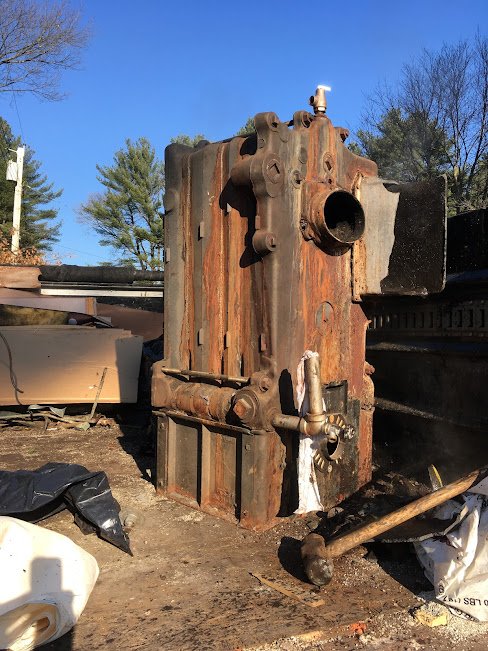

I have an ultimate cast iron boiler that is over 30 years old and still going strong.
I'm afraid I have you beat for boiler age. The original cast iron 1929 boiler was replaced in 2007, when it was 78 years old! Seriously. It was a monster. It took several strong men to haul it out of the basement.
SailinAway is offline   Reply With Quote

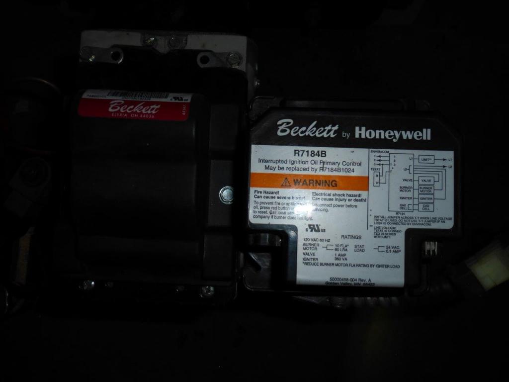

Here are some photos. I have more if there's something specific you want to see. The service card is from the first technician. The second one didn't leave a service card.

That's not a combustion test! The only way for sure you know one was done is with a printout from the combustion analyzer. They shouldn't have had any issue opening that up. The HB Smith is cleaned from the side panel. Make sure the side plates are lined up properly. Lift up that side panel, turn the heat up all the way to fire the boiler, go down stairs in front of where the panel was, shut off the lights, and see if you can see any flame or light. It doesn't say what nozzle , filter , strainer, he used or anything he did. Did he actually brush the boiler pins, remove the smoke pipe, vacuum the breech and smoke pipe and inspect the chimney to make sure it wasn't blocked? there's no proof he did any of those things except what he told you.

That's a good boiler. Time to try another technician.
I think the checkmarks indicate most everything was done.
But yeah, they usually always state what nozzle they put in.
It’s very odd technician said bolts were to rusted to remove.
They typically don’t remove that large plate, just the burner.
Dead River is good and fairly good size. I’d ask for someone more serious.
How long was it not serviced for?
Maybe it was so plugged up that a standard cleaning isn’t getting it all out.
mswlogo is offline   Reply With Quote

The check marks mean nothing without proof a combustion analyzer was used. The only way to prove it is to have a printout printed. I always left one at the customers and one attached to my paperwork. Having one can keep you out of court. I hate to say it, but most companies today are losing their most experienced techs due to retirement and burnout. I don't blame the homeowner for being upset... he should be!
This old boiler that we replaced in 2017 may have been from the same era. It was covered with sheet metal panels so it didn't look quite as scary in my basement:
