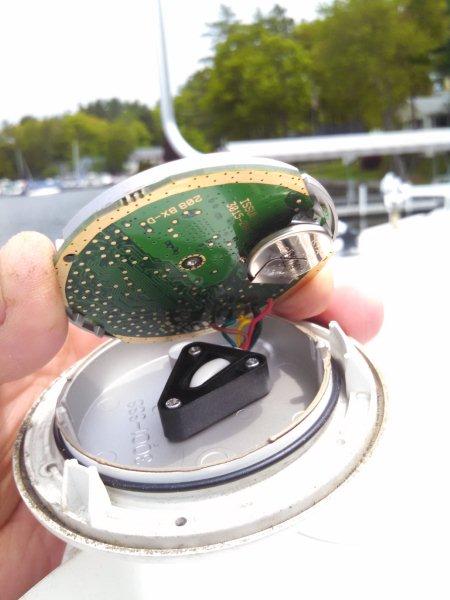

Here is the original battery as installed by Raymarine, it was a Varta 2032 3V Lithium button battery. In this picture the positive terminal of the battery is facing down or away from the circuit board, the negative terminal is facing 'up' or towards the GPS circuit board:
Original Varta 2032 3V lithium battery can be seen under the circuit board
I checked the voltage on the original battery and it was down to about 0.3 VDC. This should be at 3.0 VDC or higher.

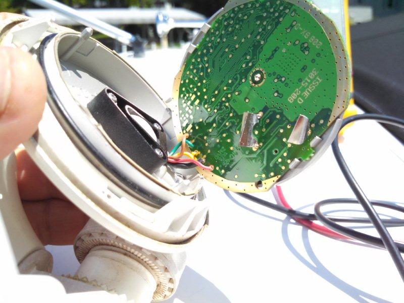

I then used some scissors (or you can use wire snips) to clip the battery tabs, but leave enough of the tabs on the circuit board to allow you to solder the new battery wires. Don't flex these tabs too much, or cut too close to the circuit board, you don't want to stress the circuit board traces too much and they could be fragile, so be careful. This way you're not taking the chance to damage the circuit board when trying to solder the new battery wires.
Raymarine RS-120 GPS with its original battery clipped out. Take note of the positive (to the left) and negative (to the right) terminals before you remove the original battery.
Next place the new battery (be sure it's fully insulated) into the base of the GPS, then route its wires to the tabs and solder them to the tabs taking important note to see that the positive and negative leads are installed properly.
Raymarine RS-120 GPS with the new battery installed. You can see the new battery insulated and installed to the left of the cable clamp. Its wires are soldered to the clipped tabs of the original battery (red is positive, black negative).
Then check the voltage at the old battery tabs after installing the battery. The one that is to the left in the photo (closer to the center of the circuit board) should be positive, and the one closer to the edge of the circuit board is negative. You should read about 3.2 VDC here with a fresh battery after it is installed. If the voltage is correct, you are done, re-assemble and re-install the GPS.
