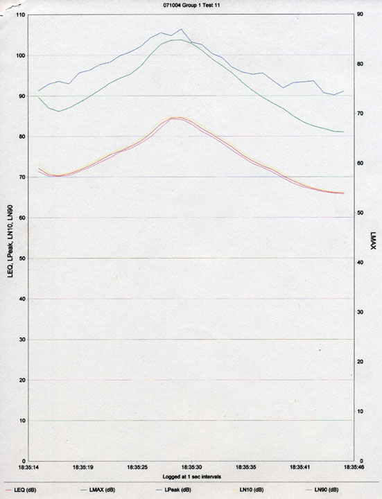

I have posted a copy of one of the sound traces that I captured this season.
These traces are take at A and some of the reading are taken at C scale.
I do this to show the level of low frequency sound that is not captured on the
A scale measurment.
This test showed a Max A weighted level of 84.9dB
and a peak C weighted level of 106.4dB, the trace was taken
over a 32 second period as the boat passed at about sixty MPH+
I was two hundred feet from the source as it passed.
So add 6dB to 100feet and 6dB to fifty feet for an add of 12dB.
You get an A rated reading at 50 feet of 96.9dB then add ten
10db to bring your to 106.9. Only .5dB off what a C scale reading would be.
If the boat was traveling at 60mph then the the test shows a trace over a half mile of operation. You can read the trace from left to right. The boat is
traveling through the sound scape left to right as graphed.

OK now you've done it You've put data before the enginerd and now it's time to pay (no good deed goes unpunished) But more seriously if you have the time I have a few questions as my curiousity is whetted.
I do this to show the level of low frequency sound that is not captured on the A scale measurment.
I think I was right with you until the 10 dB part I've underlined above. What's that for ? There are 3 very similar traces (yellow, reddish and magenta) that I understand to be A weighted measurements. I would ask if these are 3 passes made by the boat or 3 different time averages or outputs from 3 different meters or ??. If it's the first then it's nice and consistent ! Good to see that in a field test. I understand the green trace to be a C weighted measurement (not sure what the jagged blue one is). It's interesting (to me ) that the aspect angle to the boat doesn't affect the measurement more. Was your technique to pan the mic as the boat passes or leave it aimed "straight out" ? I'm making an assumption hear that the boat's course was more or less a straight line and not a curved trajectory.

I knew I was getting long winded.
I use a quest 2900 type 2 logging sound meter.
The meter has the ability to measure two scales at the
same time. I started out with a RS meter for 45$.
These are not really that good for capturing data that
will support your case. My meter is only garunteed to 1db.
SInce you can't calibate the RS meter it is worthless
for issues related to legal issues.
The three traces that I use are LEQ RED and LMAX and LPeak.
In these traces, LMAX and Lpeak are measured at C scale
with LEQ measured at A scale. What I was trying to point out is that
C scale measurements end up around 10dB higher then a C scale taken at
fifty feet from source.
This trace is made up of samples taken once a second.
My feeling is that the C scale represents the real impact of the
boat noise. The A scale really does not fully show the impact of low frequency noise. But, since the regs are set to that standard it still works for enforcement.

As for my sound traces, the data is the data,
Thats why we have so many pissed off property owners
up here. We have a problem because there is an real issue.

As for the sound of the hills issue. I have posted a document that describes
how sound wave move in a lake environment. There are many issue associated with reflection of sound waves. I think the document say it batter then I could.
