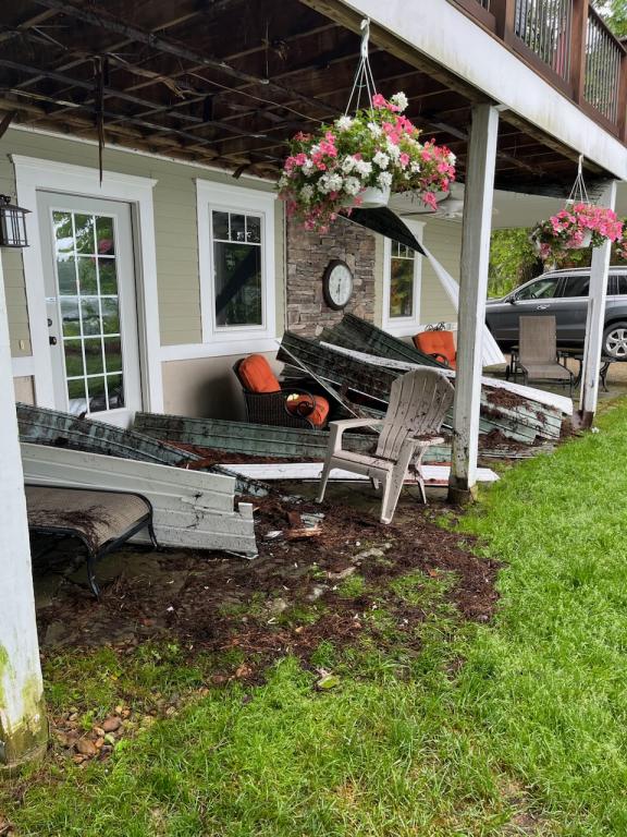

...I heard a big noise in the middle of the night during the heavy rains, but assumed it was thunder...I guess not..

Yikes! That's weird. I think I see nails but it must not have been attached very well.

I'm guessing that pine needles and other debris from the last 14 years blocked whatever drainage it was supposed to have and the water built up and it gave way.

Inside a porch is more surprising but water is tough. It can get anywhere.

I can't tell for sure...
But it looks like they used soffit material and nailed directly to purlins attached to the deck joist.
The deck joist are beginning to show some signs of rot.
They have better systems.

Yes, that's exactly how it was done. I am concerned if the joists are showing rot. A few of the deck boards on top have become punky where they get hit with roof water run-off...at a minimum, those need to be replaced. Might be time to bite the bullet and replace the whole darn thing with Azek or other material that will out-live me.

Nothing's worse than discovering hidden rot. We went to replace our porch siding at camp only to discover the whole sill had rotted out and quadrupled the work and cost.
Sorry, friend, but good luck!

Unfortunately the practicality of putting in esthetic features, is often not good. you have to have a way to get that debris out, or the result is as you have experienced..... Hopefully the frame of the deck is still solid.... a few punky boards on top are easy to replace... if you went the "roof" for the deck below, just incorporate a way to pressure wash the debris out occasionally....

''Nail Pop" occurs on both sides of a deck. The expansion/contracting of the wood wicking moisture and then drying out loosens the fastener and allows for a small amount of rot around it.
If the panels are still good... you can check the level of rot... clean it up... add joist tape and reinstall the panels, but with screws that are larger than the current fasteners. Most likely replace the purlins and wrap those with the tape before securing.
The top decking can be fixed by a mixture of either deck grates or just replacing a few boards that take the pounding from drip off the roof.
(obviously joist tape what you can under those also).
Time and Mother Nature will rip down any structure.

I don't think a hose or pressure washer would work.
The attachment to the purlins limits the gap created for the run-off of water and debris.
If you look at a system, like the Trex RainEscape, it creates a large gutter that has an opening deep enough so that all the debris flows freely to the catch basins, and the catch basins are big so less chance of clogging.
Just rather expensive.

Had they used vented soffit instead of solid you probably wouldn't have had this problem !

It would leak onto the patio below... which was what they were most likely trying to avoid.
Prior to decking, you can use Trex RainEscape... after decking you can use Timbertech Dryspace.
Other than that... you have to realize wherever the ceiling is attached to the purlin... that is the gap you have for water and debris.
Overtime, the purlins will rot, and the nails/screws will release.

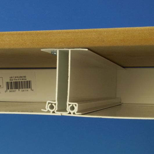

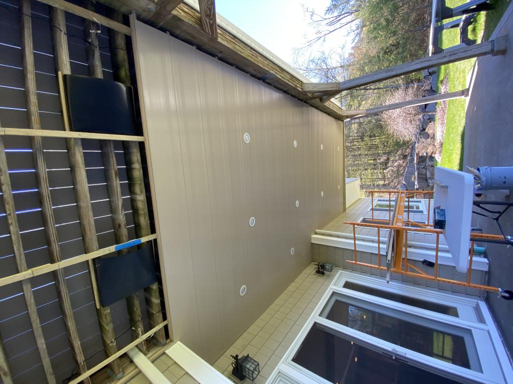

I remembered this thread from Meredithman and thought I would offer this option...
I'm in the process of doing an under deck ceiling system made by "Zip Up". This system is a "do it yourself" system and designed to be installed after your upper deck is installed which makes it nice. It's relatively inexpensive compared to other under deck systems that require access from the top and a lot less complicated to install with only three main pieces required.
https://zipupceilings.com/
https://www.youtube.com/watch?v=PGAededTruk
The system can accept can style lighting and I decided to go with lights made by Trex which are their "rainscape" can lighting which are lightweight and plug and play and require no electrician to install as long as you have an outlet somewhere to plug in transformer.
I ended up purchasing online through Decks Direct as the only place in NH to get it was at Gilford Home Center. Unfortunately they could only get certain colors and sizes that I couldn't use which I thought was a little strange. Decks Direct had everything I needed and shipped it for free and was received in 3 days!!
I'll take and post some pics once its done but thus far I have found it to be a pretty easy and good system to install especially for those of you trying to finish off underneath an already completed deck where options are very limited...

Here’s a few progress photos…Hopefully complete in the next day or two. Very happy with the zip up system!
The first photo shows the area being worked on.
The second photo shows the layout of furring to anchor system to. (crucial)
The third photo shows some of some of it completed with lights…
There will eventually be a gutter system installed at the end of the system to catch all the water.
Dan
Don’t know why the second and third pic are sideways???

Different than the DrySpace.
DrySpace doesn't have any furring strips.
The long rails secure directly to the joists and create the required pitch without any measuring... and then the panels between the rails snap in and can be removed at a later date should it need to be cleaned out.
The rails protect the wood from rot... but have sizing limits.
This is more like our new TrussCore product... but even that one doesn't use furring strips
John Mercier is online now   Reply With Quote
I did look at Timbertechs “Dry Space” but didn’t like the looks of the large corrugated panels and it was really unsightly at the gutter where all the corrugated gaps were even more exposed.
Zip Up does sell their own PVC furring but it’s crazy expensive and from everything I researched, most contractors were using pressure treated or other rot resistant wood as furring and I can certainly understand why after doing this project. Just the simple ability to rip your own custom size furring is a real nice benefit!
If this space was a simple rectangle and had no lights, this job would take a quarter of the time. While layout is critical no matter what system you use, prepping for lights really consumes time but it’s a must have in my situation. The Trex Rainscape lights are awesome but not cheap!
Dan

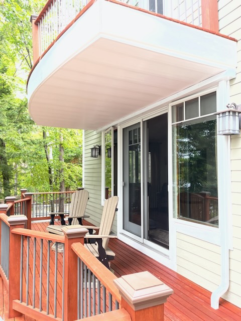

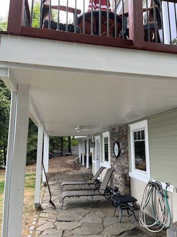

Here some final pics of my completed under deck roofing with gutter completed. Extremely happy with the Zip Up System! Simple install and zero leaks so far! I think you will be very happy with yours….
Dan
brk-lnt (06-24-2024), MeredithMan (06-24-2024)

It is a really nice look... and the specifics of how it goes together looks to be well thought out and durable.
I would like to see more pictures of the gutter detail...
That part looks especially interesting.
Others that I have seen are bulky and costly.
Alex (LaValleys - Gilford) should have information to it... but I like to see actual field installs.

That looks awesome. Thanks for sharing and congrats! We are allegedly starting in a couple weeks, so I'll put up some pix when done.
