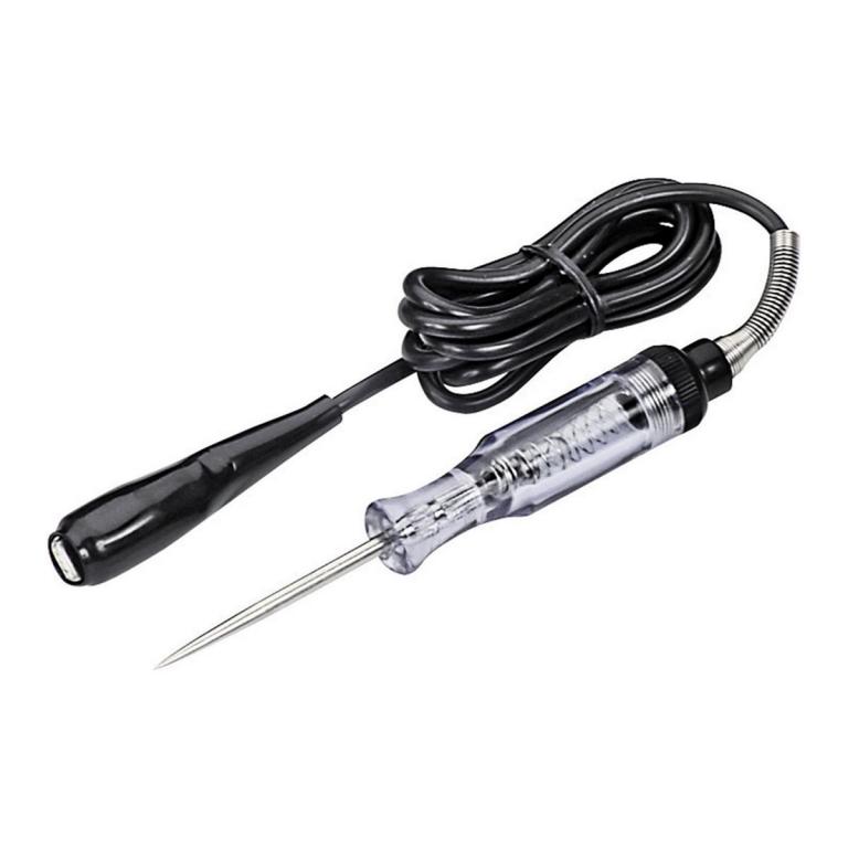

Circling back with some testing I've done...
I tried testing the trailer connection on the truck with a volt tester, but couldn't get 'any' from any of the four connection connection leads. I would think I would be able to get 12v by connecting my voltmeter lead to any one of those harness pins and voltmeter ground lead to ground, but I got no reading ?
Thoughts?

May sound like a silly question but when you were testing the truck side, did you have at least the parking lights on?
Based on your description I'd still be looking at the trailer.

Bought trailer/light tester at Harbor Freight, and tested Truck plug terminals.
Left and right taillights working fine, lights on tester lit up.
The Running lights terminal tested bad, at least the light tester did not light up!
So now I'm thinking it may be a truck fuse, more to trouble-shoot !

Old 05-25-2022, 07:42 AM   #21
swnoel
Join Date: Jan 2007
Posts: 529
Thanks: 83
Thanked 194 Times in 118 Posts
You can test the circuit using one of these...
swnoel is offline   Reply With Quote
