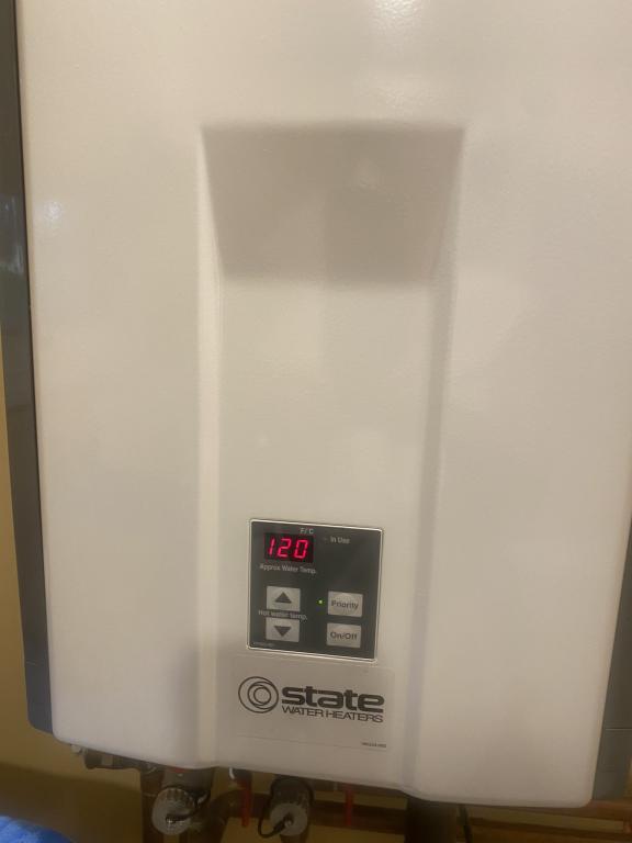

You raise an interesting point, but one that has not at all been a problem for me ever.
I can set mine at any temp and yes it gets plenty hot, once set it at 140 to see how we might like that and it was scalding!
Now I run off city water, so I have no idea how that impacts the temp vs a very deep well, but I would think the deeper you go the warmer it is???
Any deep well owners that can tell us what your cold water temp is?
Im a very long way from our treatment plant and our water can be pretty cold when it gets to me,,,

To be clear: you have an ELECTRIC on-demand water heater?
I've not heard good things at all with those, but you've been happy?
Sent from my SM-G990U1 using Tapatalk
No I have a gas tankless hot water heater and it works flawlessly well.
Never heard of an electric tankless, I dont doubt they make one, but thats not what we have.
Google them. They do make them.
Dave

I'm warming up to the idea of a small tankless unit for the shower. Can someone post a link to a suitable appliance?
EDIT: Woops, I think I meant to say "under sink water heater."

Originally Posted by SailinAway View Post
Sounds to me like a perfect example of a tankless on demand system you want. If you don’t want to pay for the expense for this system, shut the breaker off on your current system…
I have had this one for 13 years now trouble free! It is used from ice out till mid November. In the spring when water temp is 34 degrees it still heats water flawlessly! No issues with two showers going at once or laundry while showering. We use approximately three 100 lb propane tanks per season strictly for hot water and yes we have a lot of visitors so many extra showers taken during the week. The wife is also a “laundry nazi”!
I am not a plumber and don’t know much about these and all I can say is I love mine and wouldn’t be without it.
Here is a couple pics of it and the spec sheet on the side…
Dan
XCR-700 (08-04-2022)
Dan
Thanks for this. I have a 20 year old propane hot water heater (tank) on the island that I know is at the end of it's life. I go back and forth about replacing it with something like this - leaning toward doing it. I like the idea of "trouble free" as while I am willing to try and fix things, sometimes my enthusiasm is greater than my abilities - and getting tradespeople out to the islands can be a challenge, esp. when I tend to be there on weekends rather than during the week.
