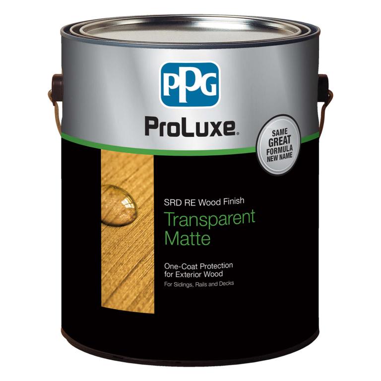

Use a Sikkens PPG product like they use for log homes. Oil base preferred so you never have to strip off a coating of finish. You can find this at Gilford True Value

Billy would be correct.
But the product being proposed is not log home siding stain. Sikkens - now Proluxe in the US - comes in several different formulations. SRD means Siding, Railing, Decking. They also have a Log & Siding formula that is a two coat process that leaves a luster.
Not sure how to stop checking... as the wood dries, it shrinks. Oil will replace some of that water loss... but probably not all.
I have seen certain wood fillers used to repair checking, but I think it would be tricky to do and have the repair go unnoticed.

Other than brands... the OP's options are rather limited.
Oil-based with UV protection in a matte finish really demands a product like the Proluxe.
The Helmsman Spar is a polyurethane with UV protection so the poly doesn't yellow and peel. I highly suggest its use on wood doors, but I cannot get it in a matte finish.
ZAR makes an exterior oil-based matte polyurethane.
John Mercier is online now   Reply With Quote

Proluxe is a decking oil.
If you apply multiple coats, it will get shiny.
Same thing would happen with Penofin when I used that.

3400 series... not the 19400 series.
NH has a VOC restriction, so we can only sell it as a quart.
