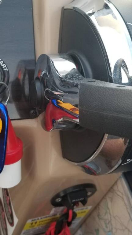

Anyone know what that black button on the side of the shifter handle does?! (Be gentle, if I should know!)Name:  20200812_193305.jpg

Anyone know what that black button on the side of the shifter handle does?! (Be gentle, if I should know!)Attachment 16344
High idle button...push that button in while moving throttle forward keeps motor in neutral yet allows motor to rev.
Yes you should know this...
Dan

Could that black button be the button you push to allow you to advance the throttle while in neutral ?
camp guy is offline   Reply With Quote
Dan
What would I use that for?
If it's like other manufacturer controls it keeps the motor in neutral and allows you to throttle up the motor. You push it in to activate it (i.e. keep it in neutral).
DesertDweller is online now   Reply With Quote
It's predominately a carryover from carbureted engines to help with starting the motor but you can use it to increase RPM's and thus water flow through the motor and things like that.
Gotcha, thanks!
You could bring it above idle to recharge a low battery.
You could warm up the engine after you first start it.
If your engine ran rough you could race it a little to see if it cleared up
thinkxingu (08-12-2020)
Yes, as Dan said.
On a cold start, I pushed the button in, moved throttle to wide open and return it to just before neutral. Turn key to start the engine. I'd run at that slightly higher RPM for about 30 seconds, then pull throttle back to neutral (button pops back out), which returns the RPMs to normal idle. Throttle is now ready for normal operation.
I did this on my Mercruiser, and I believe with my Mercury 135 Optimax O/B.
