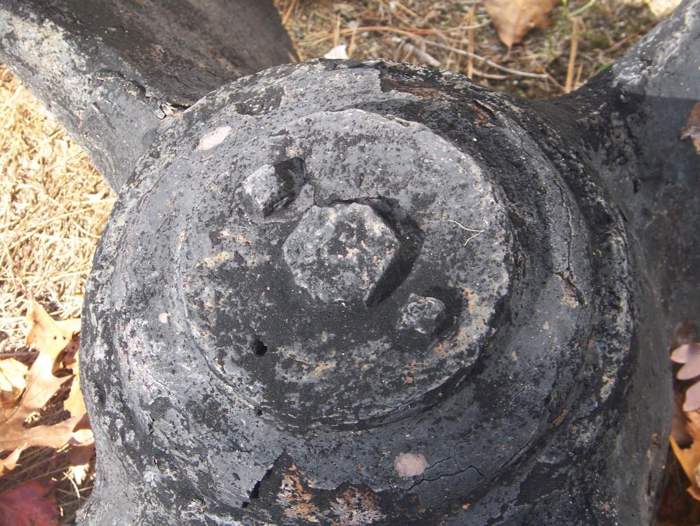

I have also re-uploaded 2 pictures of the propeller which currently resides on the lawn in front of the Tuftonboro Historical Society. Just added a few miscellaneous pics of the salvage operation.
A brief search was conducted to locate the 2 individuals who found the large propeller discussed in the newspaper articles. John “Jack” McWilliams was located in Baltimore, MD. He conveyed to us that he had an 8mm movie of the salvaging of the propeller in 1976. He had it converted to video which we have uploaded to You Tube. Jack is the person in the wet suit while Bill Chambers is the other snorkeler. Susan Hunter Weeks is somewhere on the Kitty Belle barge during the salvage process as it was her father's barge. Here is the link to the video: http://www.youtube.com/watch?v=2wctlTcTlJQ
Everything we’ve found so far indicates that the propeller belongs to the Seneca. However, investigation has determined the following facts:

Propellers were high-tech gadgets in the early 1860's. It's possible the Seneca had one bit I'd bet against it. If you can get a picture of the "Osipee" I would expect to find the same type of propulsion (as suggested above) since it would be more expensive to rebuild the power-plant to another configuration.
Please don't conclude that I am saying our forbears were cheap-skates but they do have a reputation for being thrifty!

But the question remains -- where's the rest of the (big) vessel that had such a monster prop? And, considering how well most of the big wrecks are documented around the Lake, wouldn't you think someone would note the sinking of something so large in the vicinity?
Whatever is left of the rest of whatever used that prop is out there...

Looking at the propeller as it is being lifted from the water, I was struck with a little anomaly. There is NO Propeller Shaft attached. If a boat was wrecked, wouldn't the propeller shaft still be part of what's on the bottom?
Removing a large propeller from its shaft is no easy task in the best of times..never mind underwater. I can't envision an earlier salvor disassembling the two large and heavy parts just to take the shaft and leave the prop for a later time. No hard hat and no scuba.....Maybe this propeller was being transported on a barge or vessel (as deck cargo) when the vessel sank...OR... the vessel took a roll in a squall and the prop went over the side, which might explain why no other vessel remains have yet been found.
BTW: Tug Boats usually have MUCH bigger props than another vessel the same size. Just something else to think about. NB

But the old accounts of the Seneca going down right there still leaves the question, "Where is it?"
I have a feeling we'll find something from it fairly soon. Meanwhile, the prop is a mystery in progress. Pretty cool.

http://www.winnipesaukee.com/forums/...1&d=1320042170
Close up of the prop.

This is what I was afraid of. However, that cap doesn't look like something that someone added to keep the prop in place on a foundation on the lawn. That cap looks like it's "Original" to the prop. I have NO Idea what that cap is about....ie..how that cap assembly would hold the prop on to a shaft...but I'll take a guess in a moment.
There are only two (normal) scenarios as to how a prop is retained on a "Straight Inboard" shaft.*** The shaft has a "Taper"..and the prop bore has a "Taper" that mates with the shaft. There would also be a "Key" to prevent the prop from rotating relative to the shaft. Then..there would be a BIG Nut and cotter pin on the externally threaded end of the shaft to keep the nut from unscrewing, and the prop from sliding off the shaft.
The other scenario would be the same..Except..the shaft, AND prop bore would be straight. I'm going to make an educated guess that this prop bore is straight..because cutting a tapered bore would have been more difficult in those days than today. If a rough taper or straight bore would have been cast into the hub when the prop was made....then it would still have to be finish machined/reamed.
A Third scenario: The Cap, and relatively small hex head "bolt" in the picture may have been threaded directly into the center/end of the prop shaft. The two square "Nubs" may be some sort of tapered keys that were driven in to prevent prop..or the hex bolt from backing off, and/or prevent rotation on the shaft. This would likely be a straight bore.
SO: In any case, I think this would imply that there is a broken shaft STUB in the bore. I'm not familiar with this method of retaining the prop on a shaft, but I think it would work and perhaps that is how it was done..Back Then.
BTW: Screw propellers came into use elsewhere, in about 1843.
I may have to take ride down to Mystic Seaport and have another look at the propeller and fastening method on Nellie. Nellie was donated to the museum in 1956..and May ....have a modern prop. NB
NOTE*** Modern outboards and outdrives have straight "splined" shafts and prop hubs.
EDIT: Looking back at RGs pictures of Nellie, the prop looks like a fairly modern prop with a double nut ..(no cotter pin needed) holding it on..just like it would be today.
