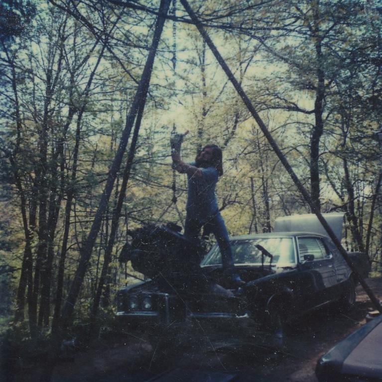

3 long pieces of pipe and a come-along

I have had this set up in a lake to change motor mounts in a Correct Craft
