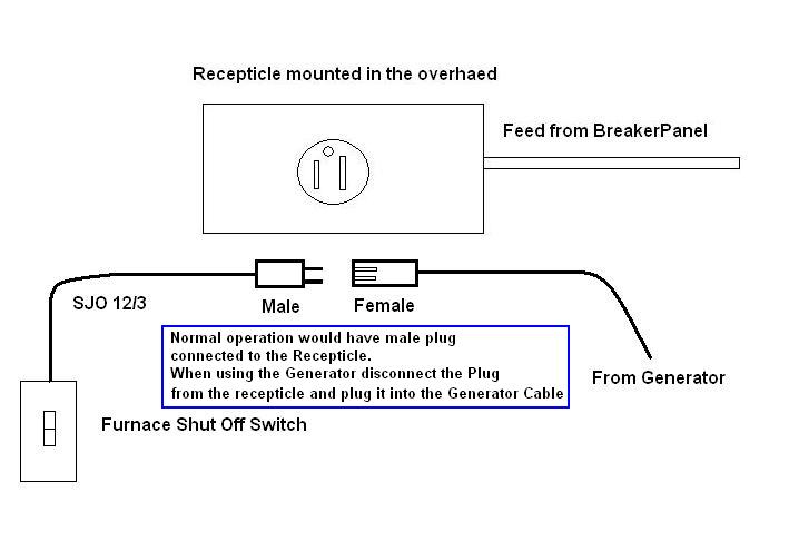

OK folks, let's get the misinformation corrected from Rusty and Lakerider.
I just snapped a quick image of one of my panels. Notice the upper right breaker and the steel plate just above it that also connects to the main "feed" breaker. That is an interlock. When power goes out, I open the main breaker, interlock goes up, and the 30A breaker connected to the generator cord gets closed. This gives the option of powering any circuit I want in the house of my chosing. You can't see in the picture but there are little white paint marks on the breakers I made so if I'm traveling I made it easier for my wife to not have to even think.
Totally legal, totally to code. Very efficient. I have a lot of money connected to my panel including line filtering and surge protection. I did not want a permanent generator for several reasons least of which I didn't like where I was going to have to place it and needing a huge gas bottle (ugly). I just built my house 2 years ago and went though the decision process.
This is precisely how a breaker panel in an existing home would be wired in (and the most economical) for a portable generator.

That is a circuit panel with a built in transfer switch. This is exactly what I have and in my opinion the best way to go over a separate gentran switch.
I think Rusty and Lakesrider thought you were simply hard wiring your generator to your panel without a built in switch. Unfortunately many people do that and it's not a good thing.

Originally Posted by lawn psycho View Post
Um, do you guys even have a clue what you are talking about?? I'll get the pictures.
Nice! Well first off in your original post you didn't mention the fact that your main is locked out or that you had the cable wired to a breaker that had an interlock installed. I took it as you simply wired a cable into your panel. Not speaking for Rusty but I'll bet he thought the same thing.
I emailed two electricians a copy of your pic. One said "no way not code." "You cannot install a permanent extension cord in place of hardwired to a generator. Not only an electrical violation but also a fire violation. An extension cord is not supposed to be placed through windows or doors, and should be protected from damage. Hence a permanently installed, hard wired switch box is used, placing the connection outside on the wall."
I haven't heard back from the other one.
But hey it is your wife hooking up to a generator, not mine.
A switch box will simply allow you to the flexibility, and safety to not have to shut off your main breaker because the circuits are isolated by the switch.
When the power comes back on the lights and other things in the house will come on and alert you that the power is back on so you can shut off your generator.
So next time you want to tell people we don't know what we are talking about....be a bit nicer. I may not know everything...but I am smarter than a 5th grader.
You need to find a new electrician
Why can't you answer a post without being sarcastic?
I said "Hooking up $75, 20-25 ft long cord to your existing circuit panel without a transfer switch is not recommended". The key words in my statement are "without a transfer switch". You didn't say that you hooked it to an interlock switch or anything else.
Maybe you think that average person should know that, but I don't think so.

OK so getting back to it...Cate....just make sure you get it professionally installed. This way if there were ever an issue you'll be covered on your home insurance.
BTW...I love the fact that we agree to disagree here. . I just want her to get it done safely and correctly that is all.
I actually just called the State Fire Marshall's office (in NH) to close this out.
The panel interlock is new(er) technology and removes the need for the gentran switch.....

Oky Doky...I just talked to a local generator company. They say it is legal to have the interlock such as the one in the picture. However they only install #10 hard wire inside the box and wire through the sill to a the female outlet with the twist lock plug going to the generator. If you want a switch it is primarily for the convenience that I mentioned.
So there are two sets of ideas going, which is why I suggest a professional install it and she is covered.
So I'll eat half a crow on this one and call it a day!
No, I think you guys are too sensitive. I wasn't being sarcastic.
A licensed electrician would know about the interlock (this is not a transfer switch). I was giving a geveral description of how the generator is hooked up, not a detailed "how-to". Hey, all I'm trying to do is give someone the information about the most economical way to get a generator set-up.
And to add, the Fire Marshall's office said that the generator is to be 10 ft from the house. I did not get into details about portable vs fixed and venting, etc, etc. The NEC is also subject too interpretation and despite all their efforts, ambiguity still exists. I also happen to have an NEC code book right on my desk....

kamper
Here is a neat and clean way to re-wire the furnace and not even have to turn the Furnace breaker off.

WINNOCTURN, now that is so straightforward that many will have a hard time getting their mind around the concept!
Actually pretty neat. The only downside I can see is not having the use of the upstairs emergency shut off switch as I assume you have this right above the furnace.
We do have a single circuit transfer switch that I installed at the power panel to power the furnace.
http://www.reliancecontrols.com/Prod...il.aspx?TF151W
WINNOCTURN (02-24-2011)

Slick,
The way my Furnace circuit is run, the cable starts at the breaker panel, goes to the first floor "Safety Switch" (the one with the RED cover plate) then down to the Furnace Shut Off switch witch is mounted directly to the side of the furnace. With this type of run the first floor switch could be used to initially turn the power off to the Receptacle and not have to go to the breaker.
On my switch box at the furnace there is a wired receptacle for my condensate pump (AC). When you power up the system you can plug in a lamp of some type to light up the area.

Unfortunatly that is not in code. Neither is the way I do it but for an emergency situation nobody is going to bother me. Lovel the diagram though.

One more bit of information, interlocks on circuit breakers to transfer from normal power to generator power is not acceptable to some utility companies. Best to check with someone that knows local regulations before installation.

After reading the most recent 18 or so posts about generators and hooking up generators I am scared to absolute death about what some of you are doing. Any one who thinks that no one worries about Code in an emergency is totally wrong. The Code is all about life safety, not whether or not you have power.
Please, people, DO NOT TAKE SHORT CUTS when wiring up a generator, of any type or size. Use the services of a qualified, licensed electrician, and keep in close touch with your local Building Inspector and Code Enforement Officer.
There is no substitute for doing it correctly.

My feelings regarding power outages is, one needs to install one of these to put yourself safely at ease. The $6K for the unit (17 KW), excavating, purchasing the 2 100 gallon gas tanks (7 day supply)and all labor for the gas and electrical conections and the best transfer switch is one hell'ave cheap cost for peace of mind.
This is why the lineman either work the downed lines as assumed live or they physically disconnect the circuit they are working on. People always talk about protecting the power company but it's really to protect their personal electrical system and house.
A generator not disconnected from the lines won't like being turned into a motor when power is restored.

I have never said this in a forum before, but I am going to right now. I totally disagree with the under lined part of your statement. Line man can be working at several locations on a particular line and they do not shut the power off to ALL locations. SAFETY is the number 1 reason to notify the power company about generators and to have certified electricians wire units to CODE. If they didn't need to they wouldn't take the time to write the code for safety.
I agree with you RLW...
This is what PSNH has to say about it:
"When improperly installed, a generator—no matter how small you might think it is—can backfeed dangerous amounts of electricity into the electrical grid beyond your home. The electricity, once on “the grid” is quickly “stepped up” to much higher and dangerous voltages. This can cause fires as well as be a danger to nearby residents, and to utility line technicians."
