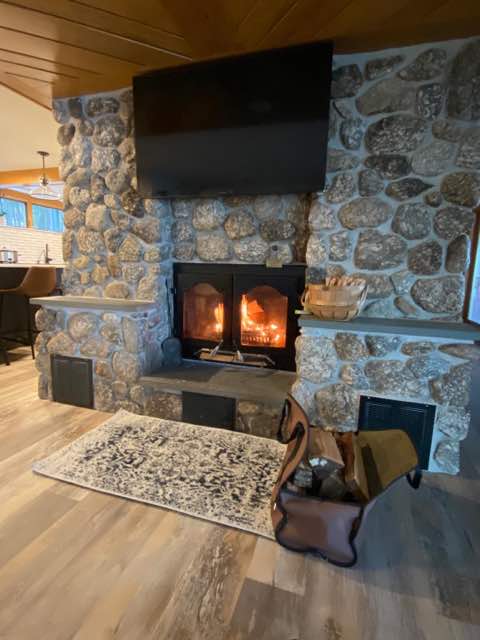

Old 11-17-2022, 09:50 AM   #15
WinnisquamZ
WinnisquamZ's Avatar
Join Date: Dec 2016
Posts: 1,599
Thanks: 167
Thanked 509 Times in 341 Posts
Default Does this woodstove need a damper?
is that type of morning. We have a fresh air supply that runs down from the attic under the firebox. Helps with the draft

Attachment 17891
That's a pretty setup. Are those regular heater vents or somehow plumbed to the insert? If not the insert, how loud are the fans to get the insert heat out?
We went with a standalone hearth unit so it would be silent and not require electricity, but your setup looks pretty awesome.
Thanks, it’s a Queen Air insert build in 1987. Both are fan driven air intakes that supply outlets in the other parts of the house. Are they loud? You can hear them so we use them sparingly. It’s the last thing standing as we remolded the space last winter
