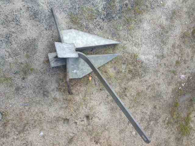

Anchored off Bear the other day and got my anchor hung up pretty good! Any advice on how to avoid this the next time?Name:  ImageUploadedByTapatalk 21374633719.267499.jpg

and you bent the fluke.
Next time back off in the opposite direction and dislodge the plow. You could also attach a float attached to the fluke, that if needed gives you a proper manual leverage to dislodge the anchor.

Don't anchor in the rocks. It looks like the anchor was hung up on something, either the rocks or a big log. How did you eventually free it up?

First, get a stronger anchor, that one looks pretty thin. I like a plow anchor, it doesn't have flukes to get hung up as easy.
Second, it's Winnipesaukee, it's rocky, unless you stick to sandbars eventually you will get an anchor stuck. Buy cheap anchors and live with the cost of cutting one free every few years.
Third, there is a technique of connecting your rode to the crown of the anchor and then using a tie-wrap to connect it to the normal spot. If you hang up, a strong pull will break the tie-wrap and allow you to pull the anchor out backwards. I never tried it.

OMG, how on earth did you get that free???
Never seen one bent up so badly,,,

i cannot believe the line did not snap first
WOW

Must say I am impressed with the carnage... The good news is I don't think you had much issue getting the anchor set and holding you in place...
Most of the ideas present here are sound... And I think JRC made the most sense, Don't spend anymore on an Anchor then you have too.. that way when you do have to cut your losses, you will not feel so bad about it......
Last many companies around the lake offer dive services... I am sure you could hire a diver to retrieve the anchor for you... the question is what would the cost be compared to just getting a new anchor... I would think the MP what cut you some slack, if you tied a buoy to it, and notified them that you had a diver on the way to retrieve it...

I have found a few and I changed to a plow this year from the original fluke anchor and have no issues so far!!!

A plow is on my wish list for the winter. I tried every possible angle to free it up, finally hit reverse at about 2000 rpm to break free! I was sure I was going to part the line or chain, but never did!
I did have the anchor straightened out to get me through the rest of the season. If it gets hung up again, it may be another landmark for Shark Bait to tour!

UASCG auxiliary boats (facilities) are often equiped with a neet rig just for this situation.
You take up hard on your stuck anchor rhode so that it is "up and down".
The facilitiy will take a line with a large shackle attached to it. The shackle is put around the anchor rhode and allowed to slide down the straight line.
When it bottoms out it should be around the stock of the anchor. While you slowly back out the facility backs in the opposite direction. You stop and he keeps backing out. The shackle will pull the anchor out backwards and free it up. It works.

Unless you anchor in areas shallow enough to "scope" the situation out, you can't really avoid it.
• I bought a similarly twisted Danforth at a garage sale, figuring with a big vise and big pipe, I could straighten it out. While it did get sorta straight, I was unimpressed by the strength of each part. I wouldn't put it in "serious service" again, except maybe as a backup anchor.
• Even a mushroom anchor can get stuck in a rocky substrate. In one case, I could see through 15 feet of water that my mushroom anchor had simply slid between three large pointed rocks whose tips were touching. With one finger on the rode, I was able to slide it back out visually.
• My next door neighbor had lodged his anchor in a rocky area, and left a float on the line to return later. Finally giving up, he was about to cut his anchor line, when I suggested we take my rowboat and "do circles" with the anchor line stretched taut. It took perhaps 15 minutes, but we got it out—undamaged.
