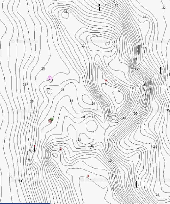

Exclamation Navionics LakeVu Winnipesaukee Problem!!
Garmin "Navionics" LakeVu problem for Lake Winnipesaukee
Lake Winnipesaukee boaters, please be aware Garmin LakeVu charts, a Navionics cartography chapter, formerly known as "inland lakes and rivers" or "Lakes Detail" etc, has released an update sometime in the summer of 2022.
Photos below show general nav markers are NOT as they once appeared in the previous versions.
Please submit a chart error report with Garmin here:
https://support.garmin.com/en-US/nav...v7xfWdLi58LR9/
Only if more users bring this to their attention, will it expedite a chart update.
LakeVu, by Navionics, now owned by Garmin, is NOT the same as the free "Navionics" app on your phone. Please be aware this is no fault to your service provider, but is an issue with the cartography itself.
If you have a previous version of LakeVu, DO NOT UPDATE via active captain as I am not certain you will be allow to back rev.
Until there is a fix, there are no decent charts available for use with Garmin that have auto route guidance.
Raymarine Lighthouse charts do not cover the lake nearly as well as LakeVu did. Bizer will not work with new model Garmin displays. Furthermore, Bizer is owned by C-MAP.
Cue the Jeopardy music while we wait.. or file a report with detailed screen shots and we might see an update faster.
Currently, only channel markers and lighted bouys are displayed correctly on the latest LakeVu, of which, is v23.xx however traditional spar makers are depicted without color and without proper information under 'info'. Traditional spar markers are identified as "beacons"
Firmware and chart updates do not fix the issue nor is there a setting on the display. it is within the recent versions of Navionics LakeVu discovered late summer 2022.
Pre LakeVu G3 V22.xx appear to be ok, its only 23.xx that has the issue!
SEND IN YOUR REPORTS!

I've been in communications with Garmin over this issue since last August. Pinging them periodically (almost monthly), they keep telling me that the fix is in process, but they can't tell me a timeline of when it will be released.
Their latest info as of March was this:
I have checked with our quality team and it has been escalated to the engineers as it is related to the display of the buoy icon rather than the characteristics of the buoy information. This is a bit of a longer process to update; hence the delay.
I know of TWO other Winnipesaukee boaters that have this same issue, @Downeast this makes at least four of us! I'm sure everyone has this issue, but perhaps they just choose to ignore it?
Basically, they removed the Red Top/Black Top coloring for the Navaids on the lake. Now you only get to see a white rectangle! To me and others this is a hazard for navigation as you can't decide which side of a marker to pass safely.
The Garmin charts do show some solid red and solid black markers, but do not properly display the red-top and black-top markers. We all know how important this information is!
If you zoom in on this via the Garmin map viewer you can see the issue clearly:
https://maps.garmin.com/en-US/marine/?key=drv0p1mwvmxu
Ironically if you look at the same area via the Navionics chart of the same area, but choose a non Garmin chart then the NavAids all look correct:
https://webapp.navionics.com/?lang=e...key=uxbiGdxyrL
Attached are two photos to highlight the issue if you have difficulty using the chart viewer.
I also asked them to try to make the "suggested route" line more obvious as it gets lost in the clutter of depth lines, etc.
In talking to Garmin if you agree with this problem, submit a problem report and include the use the issue code CER-2015 so that they will know that many others are having this same issue.
Now that Navionics is handling the charts for Garmin, after reporting the issue to Garmin, it gets forwarded to Navionics.
Here is the note from the Navionics Product Support Specialist.
A CER report can be made through our online form - https://supportforms.garmin.com/en-U...-error-report/ and in the description they can reference CER-2015 so we can link them together but it is not necessary for the processing. If they don't want to fill out the online form, an email can be sent to help@navionics.com with their product details and we will happily create a new CER for them. Just have them reference CER-2015 in their email.
And further clarification on what CER-2015 is requesting as of March 9, 2023:
Unfortunately I have no time-frame for when it is going to be released. The icon display is the item being worked on to show the red top or black top at a glance instead of having to go into the details of the buoy to find out that information.
I can certainly suggest a different coloring for the recommended tracks in the area instead of being a black dotted line with black depth lines. I'll submit the form and you should receive the separate email letting you know it is submitted. Those are sent to the engineering team directly and I won't have access to that particular suggestion but you should have some information on how to respond/request contact.
I'll add that you only get ONE free update from Garmin on the chart within a year of purchase of your device! If you issue this bug report (including CER-2015) as a hazard to navigation to Garmin, I'm guessing that you can request a free updated chart when they fix the issue. When I called into the Garmin support line and discussed this with the Garmin support person, they made a note in my account to be sure I will receive the updated fixed chart at no charge, even if my "one free update" had expired (you must update the one free chart within a year of purchase).

Here's another example.
So you're on the lake, perhaps the sun is in your eyes, or the lighting is such that you can't see the colors clearly on the navaids. Perhaps you're in an area where you don't travel often.
So you glance at your Garmin to make an informed decision on which way to pass the markers that you can see coming up ahead.
Here's what you see on your display, which side of these markers do you pass?
Yes of course, check your paper chart, know where you are, use your compass, stop if needed, but the Garmin GPS should have been helpful here, instead of useless or confusing.

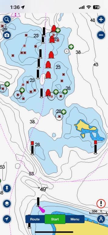

Here is essentially the same area of the same chart in the Navionics web viewer.
The markers are much more visible (black rectangles) and have a color square on top of them to show red-top vs black-top type of navaids to indicate which side is safe passage.
It's a simple change, and the information used to be on the Garmin charts. So we're trying to get them to fix this issue. They seem to be listening, but it's taking some time to get the results published.

And this is a screen shot of the same area on the Navonics chart on my I Phone. Much easier to visualize and navigate.

I'm only two days into using the new Navionics+ chart on my Garmin, but it seems to be a definate improvment over the Garmin G3 LakeVu chart!!
See the attached photo, you can see all the black-top and red-top navaids. They all seem to be there! If anyone wants to see a closer look at a certain part of the lake, let me know and I can try to post a screen shot.
I'm guessing that Garmin will phase out their G3 charts. If you look at their new chartplotter displays on their website, you will notice that the newer versions come with Navionics+ instead of their Bluechart G3 charting.
I'm further guessing that they won't update the current G3 charts to 'fix' this issue, but won't admit it to us.
I chose to purchase the Navionics+ 'U.S. & Coastal Canada - Lakes, Rivers and Coastal Marine Charts' NSUS001L (currently $199 retail). This covers the entire USA, so if I ever bring my PWC anywhere in the USA I'm covered. There is a "USA East" NSUS007R that is less expensive version (currently $149 retail) that covers part of the east coast (including our lake) if you know you will never travel south of South Carolina, this or the previous mentioned chart may be an option for you. I understand that Garmin sometimes has these on sale at different times of the year (perhaps March?).
Summary: It looks like we need to purchase the Navionics+ chart to get usable Navaids for inland waters of NH. The Garmin G3 charts in their updated form are not useful for navigation because the visual indication for red-top vs black-top navaids are missing.

Winnipesaukee Garmin Users, yesterday I received an email from Garmin which informed me that the U.S LakeVu chart has been finally updated!
I honestly was surprised to hear this news from them. I thought that they stopped updating the G3 charts as all their new products seem to come with the Navionics charts now.
Yesterday I updated the built in G3 map of my EchoMap 73sv UHD. It certainly took some time to complete the process (a few hours), but it was successful!
The new map is "US LakeVu g3 Detail Map v25.0 v2024.0"
And YES! We the black-top and red-top navigational markers have returned! The chart seems usable again!
While I haven't been on the lake yet with it, I did pan around manually and see the colored markers have returned, no more empty white rectangles!
While I was at it. I also updated my firmware to the latest version (27.10)
So you no longer are forced to buy the Navionics chart to fix this issue.
If you have a unit that is still within the 'free chart update' period (I believe one year from the purchase date) I would suggest that you update the built in chart as soon as you can before you lose the ability to have a free update.
Alternatively, if your unit is missing the red-top and black-top navaid markers, perhaps you can plead your case with support that it's dangerous for use for navigating, and they may give you a free or discounted update?
Considering that I originally reported this issue to them about 2 years ago, support gave me a 'special case' free upgrade. I'm a bit disappointed that it took them so long to resolve this issue, but at least it's resolved now.
