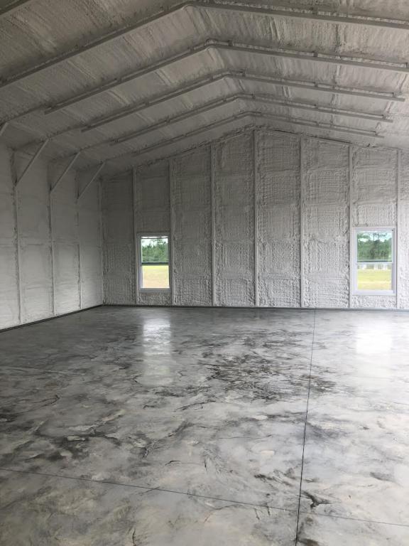

WE had our garage floor diamond shined and I was very surprised at how nice this comes out. It has a design almost like a marble look. It will never peel!
What is "Diamond Shined" tis??

They take a big concrete floor grinder with a diamond blade and go over and over it.
What company does this type of service?
This is the picture.

Attachment 18379
Wow! That looks great Tis.

Attachment 18379
That is some serious polishing! Looks amazing!!

If you are asking me that, we didn't use one. The can do a sealant but if they are happy with the results they don't need to do one. You can do colors or lakes and all kinds of things with epoxy if you want.
No sealer is too risky for our shops.
Meredith was done with a chemical hardner that ''densified'' the concrete, and then multiple different grits until the owners were satisfied (could have gone further but chose not to). In the paint aisle you can notice the red pigment in an area of the concrete, someone spilled paint tint prior to the floor getting sealed.
The intent was for the night cleaning crew to do something like wax to build a protective layer. I think he does that with the little zamboni... as under the shelves appears different than the open areas of the floor.
