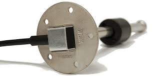

Find the fuel level sender and its mounting plate on your tank. Hopefully it will be in an accessible location to allow you to look into the tank through its opening. If you can find the fuel sender, but its not in a location that will allow you to look into the tank, don't try this procedure, as I'm not sure if you can do the job properly. As you read the rest of this you will see why you must be able to see all the way to the bottom of the tank via hole for the fuel sender.
The fuel level sender may look like, or similar to one of these:
On my boat I had to remove parts of a cabinet by unscrewing things, and remove an ice maker. Then beneath a mounting plate for the ice maker was an access port. Beneath the access port was the fuel sender. Yours will be totally different, but most boats allow for access to the fuel sender in case it needs to be serviced.
Mark the position of the fuel sender before you remove it, draw a line across one side of the fuel sender and extend the line onto the top of the tank. This may or may not be important, as some senders can only be installed one way, but to be sure, use a marker so as to be able to re-install the fuel sender into the same position as it was before you removed it.
