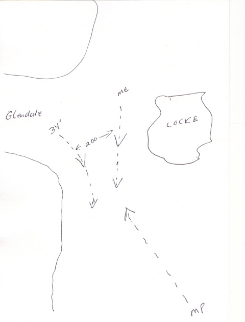

SteveA 09-18-2006 02:41 PM
Easiest way to explain the situation
1 Attachment(s)
Thanks for the comments...
I think Cal is right... I should have just slowed more than I did or stopped. With the chop in the channel I was just trying maintain headway speed..
What the MP yelled to me was, I was more than headway speed within 150... He didn't "pull me over".
What was unnerving was I started the slight turn to port to stay more than 150 from the 34'.. and saw this small boat coming right at me from 300-400 ' at high speed.. that was the MP.. (I didn't know it at the time.)
Lesson Learned....
Thanks to all
Attachment 958

upthesaukee 09-18-2006 05:00 PM
Gotta love 20-20 hindsight
especially with a map!!!!
If you had ducked in behind the 34', the MP should have kept both to port, that is assuming everyone else did what you expected them to do (someone else already said don't bank on that thought :rolleye2: ). Of course, you could have taken the hard left, and gone up through the channel between Rock & Locke:D :D :D .
Glad it worked out for you SteveA, and thanks for bringing it up. I actually will be keeping my boat in Smith's cove next year, so I will probably get to see a lot of this.

Dave R 09-19-2006 09:05 AM
Steve A, Now that I see the diagram, I understand why you steered to port. I think I would have too, and then slowed as the head-on boat approached at speed. Sorry if I was rude in my first reply. You basically dealt with one problem at a time, and I think that's usually the best approach. That's a dicey area to boat. Won't be surprised (but I will be disappointed) if they make the whole area a no-wake some day.
The 34 foot boat's captain should have throttled up momentarily to clear the area (best choice) or throttled down and let you pass; just to avoid a "situation", even if he/she was not obligated to do so. If it were me, I would have been long gone by the time you arrived at the original point of intercept, I always lean toward throttling up; hard to be in an accident if you are not there :D
If you failed to slow to headway speed at <150 feet, the MP did the right thing. Glad it was just a loud-hailer warning and not a ticket. I think the 150 foot rule between boats out in the open is kinda silly. MP must've thought so too. Can't say I have ever seen a pontoon boat "pulled over"...
Mee-n-Mac 09-19-2006 10:38 AM
Tough situation
The diagram makes it a lot easier to envision but still there are some ambiguities that make it hard to give you the exactly correct advice so take this FWIW. As the 34' came out he was the stand-on vessel and so you needed to slow or turn away. Depending on where the MP boat was and exactly the relative positions of yourself and the 34'-er, you had several options. One was to do what you did and this doesn't seem unreasonable. You also could have continued turning to port so as to allow enough room for the MP to pass btw you and the 34'. Or you could have stopped dead and let the situation resolve itself. If the MP was far enough away you could also have slowed to allow the 34' to pass and then turned in behind him to follow but only if such a manuver wouldn't have put you in immediate risk of collision with the MP. So w/o being there I can't say which is the best option. A good rule is to always act in a predictable fashion so others can figure out what they need to do. The best thing now is to give it some thought and figure out what you'd do in a similar situation in the future (hence your post). I'm a bit curious as to what the MP boat did. He was the give-way vessel in any case and ideally he should have slowed or stopped far enough in advance to avoid further complicating the situation. Was his warning that you were too close to the 34'-er or to his boat ?

Airwaves 09-19-2006 01:16 PM
In looking at the diagram I probably would have steered the pontoon to starboard and fallen in behind the 34+
That would do a couple of things. It would eliminate the wake from the 34+ rocking your pontoon broadside and smoothed out the ride since you'd be in his wake. Yes you'd have to cross his wake but doing it at an angle to the bow is easier on the passengers.
It would have also eliminated the head-on situation.
This is assuming that both you and the 34+ ended up beside each other once the 34+ changed course and headed out into the lake. If you were ahead of him then you were the stand-on vessel to the 34+.
As far as the MP goes I believe both you and he should have steered slightly to starboard to avoid the head-on situation, unless the MP was restricted by draft (how close to the bouy was he?)
I know, the purists will say all vessels in a lake are restricted by draft but you know what I mean.
Mee-n-Mac 09-19-2006 08:22 PM
Port-port prefered but ...
The above is my gut feel for the best answer but if the 34'-er was abeam of SteveA then there might not have been enough time/distance for him to fall in line w/o putting himself into the path of the MP boat. The above allows everyone a nice port-port pass to resolve the scenario. I dislike forcing the MP (via a harder turn to port assuming the rocks would have allowed it) to shoot the gap between SteveA and the 34'-er unless it could have been telegraphed far enough in advance. The 300' - 400' mentioned previously sounds a bit too close for that. In some ways the MP boat, being the give-way vessel to SteveA, should have signalled his intent early via slowing and a turn to starboard. This would have allowed SteveA to cross and fall into line behind the 34. Assuming the MP didn't turn then perhaps the best answer is to have SteveA slow a bit (to allow the 34 to pass) and then parallel the course of the 34'-er at a legal distance. Now it's up to the MP boat to do his part. If he slows or stops and the distance btw him and SteveA falls to 150' then SteveA is also required to come to NWS. Is it this last bit that didn't occur and got the MP's attention ?
ps - Almost no matter what, because SteveA is going just above NWS, any manuver he does (or doesn't do) isn't going to create much of a difference in the trajectories.
pps - And kudo's to SteveA for bringing this up. A good discussion on one of the real life situations faced on the lake rather than the easy boat on boat encounters discussed in manuals and courses.

Airwaves 09-20-2006 01:05 PM
Dave R
If you are leaving a dock, slip or tie-up mooring, you must give way to all approaching vessels.
You're right, that is a stretch in this situation. I wondered about that statement myself when it was posted it but I didn't have a chance to look it up to see what rule you were quoting.
Given the diagram SteveA posted I am confused why anyone would say Steve turning to port would be correct?
Perhaps I don't have a grasp on the distances involved but it seems that turning to port would have put him on a headon collision course with the Marine Patrol boat.
Mee-n-Mac 09-20-2006 04:49 PM
Distances
Yup and it comes down to the distances involved. If the MP had been "far away" but on a collision course SteveA could have been very proactive and turned hard to port, potentially going up the channel btw Lockes I and the rock field. The problem is, as you point out, that the MP could very well turn to his starboard (a normal action since he is the give-way vessel re: to SteveA) at the same time and you end up with both boats back/still on a collision course. Sort of like 2 people both stepping to the same side of a doorway to allow the other to pass. SteveA mentions above that the MP was maybe 300' - 400' away after dealing with the 34' and so IMO this is too close to do the above.
SteveA mentions a turn to port but his diagram doesn't really show it. I assume that this turn occured at or before the "Me" shown in the diagram, as he saw the 34' coming out of Glendale and turning away to follow the shoreline. The MP is, perhaps, out of the picture at this point and so a slight turn to port, so his course parallels that of the 34', doesn't seemed unreasonable. If my assumption is correct then perhaps it would have been better to have slowed a bit, continuing on the original heading, and fall in line behind the 34'. This still would have left a crossing situation, potentially a collision course, and so the MP still had the responsibility to give-way. Given the speed of his pontoon boat I think that this course correction wouldn't have made that much difference in his position relative to the MP. Kinda hard to judge it all from a hand drawn diagram but fun to muse about. Still not sure whether the MP had a problem with SteveA's distance from the MP boat or the 34'-er.

I was assuming that the maneuvering began at the point of the diagram, not prior to it.
