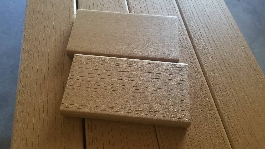

Lumberock "Premium" Decking
1 Attachment(s)
Hi All,
As mentioned in another thread, I ordered Lumberock for my home and camp decking. It is 100% non-wood material, very light, and very stiff. I ordered based on feedback and photos from ishoot.
I won't have either project done for a bit, but if anyone's interested in getting a sense of the material, I have a few small pieces to look at and Lumberock offers free samples. Supposedly, it's bulletproof.Attachment 17071

Are you talking about composites as a whole?
We put those two little pieces in direct sun for a couple hours, and they weren't hot to the touch at all. I'll know for sure when actually installed, but one of the selling points of this material is that it's not as hot as composites.
No idea on slipperiness, but if the source of the recommendation had it on a dock for five years and then bought more, I gotta think it's ok when wet. I'll report back when the decks are done!

thinkxingu 06-29-2021 01:46 AM
Started putting the new decking down on the first deck yesterday morning, maybe the hottest of days we'll see this summer! We should finish today, and I'll post pics*.
The material is super light and easy to carry, cut, and work with. It's not *quite* as stiff as I'd thought, but at 16" OC it's certainly solid. I ended up doing a bit less overhang than I had with PT just to be sure.
*The heat certainly impacted our...precision. Some of the notches are a bit loose, and I'd previously decided not to picture frame in favor of simplicity, but we should be done in two days and I'll never have to deal with it again (and when I replace the railings next summer, the post covers should cover some of it!).
