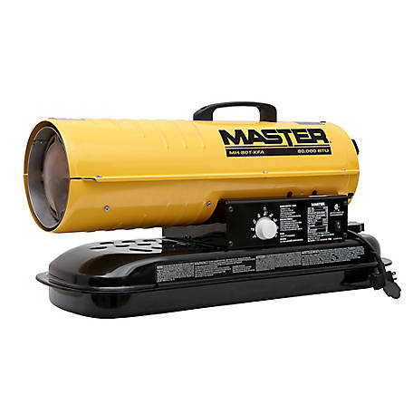

1 Attachment(s)
Do you mean a "Torpedo Heater?" I understand you need good ventilation.
I prefer electric heaters to avoid fuel and exhaust issues. I got this image from the Tractor supply website.

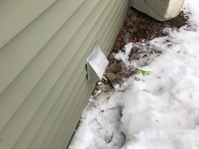

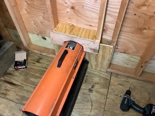

bouyhead 02-24-2021 12:48 PM
2 Attachment(s)
I'm using the torpedo style heater and burning kerosene. Running it with the door closed is a no go. When it's not to cold I was running it with the garage door cracked open but it wasn't very efficient. I devised this little cutout to bring in fresh air. You can pull out the heater when not in use, don't forget to put some screening on the outside vent to keep the critters out.
Attachment 16811
Attachment 16812
