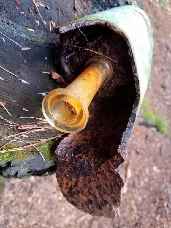

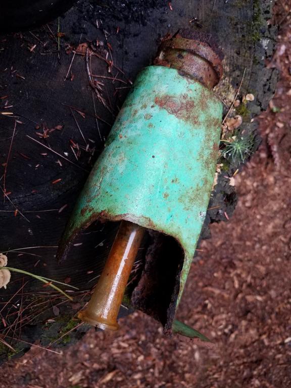

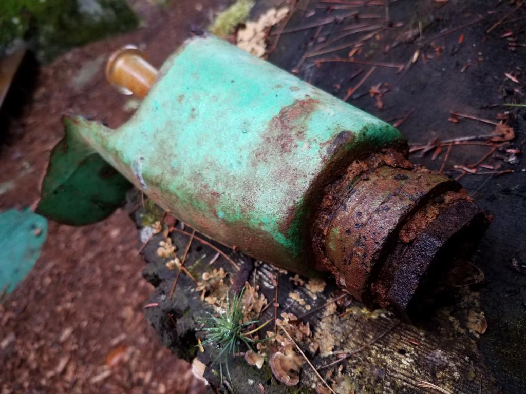

Would someone be able to tell me what this may be?
Attachment 14280
Attachment 14281
Attachment 14282
jbolty 10-08-2018 02:30 PM
looks like a check valve for a water intake of some kind
Top-Water 10-08-2018 02:38 PM
Just a complete guess, maybe some sort to heat exchanger from an old boat. In one of the images it looks like it has a flared copper fitting, but in one of the
other photos it (seems) like it has a plastic fitting.
Looks like it could have been split by water freezing in it by the look of the jagged edges. Just a guess.
Top-Water 10-08-2018 04:47 PM
Another complete guess?
Maybe a floor jack / bottle pump style jack with the rusted parts opposite the what looks copper? fitting as the telescoping threaded assembly that lets you adjust it a little before lifting. Maybe not frozen apart, possibly blown apart.
On the far right of the first photo is that a large hexagonal shape that you could put a big wrench on?

Broken Glass 10-09-2018 09:46 AM
Jet Water Pump
Looks like the nose cone for a jet pump. The tapered venture tube is a clue. Looks like someone did not drain their pump and it froze and split apart.
Bear Islander 10-09-2018 04:37 PM
1 Attachment(s)
It's a jet pump injector. No question.

DonBearIsl. 10-10-2018 04:16 PM
I was thinking pump parts. To clarify, that tubular piece in the center is glass. It is cemented in to the green steel portion...

ursa minor 10-11-2018 09:22 AM
1 Attachment(s)
Originally Posted by Top-Water (Post 303474)
Just asking, What is a "jet pump injector", what does it do as part of a private well system.
Nice detective work.
The venturi in the "injector" ( technical term would be an "eductor")uses a portion of the pump discharge to increase the suction head or "lift" of the pump.
On the cut away view below, the discharge of the pump enters through the venturi area and in combination with the nozzle induces water flow from the suction. The jet can be either integral with the pump as below or a separate accessory with some extra piping if used on a well casing.
